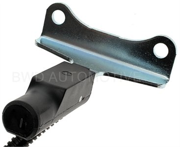

What DOES the crank sensor look like
Please don't forget to rate!
  1. Remove the air cleaner assembly if necessary for access to the sensor.
  2. Disconnect the pigtail harness from the sensor.
  3. Remove the nut holding the sensor wire clip to the fuel rail mounting stud.
  4. Remove the sensor mounting hardware, then the sensor.
  5. Remove the clip from the sensor wire harness.
To install:
  1. Install the sensor flush against the opening.
  2. Install and tighten the bolts or nuts, as applicable.
  3. Install the electrical connector.
  4. Install the clip on the sensor wire harness.
  5. Install the clip over the fuel rail mounting stud. Install the clip mounting nut.
These 4 pictures are for the Automatic:
These are for a manual trans:
12/7/2025 1:45:14 PM • 1999 Dodge... • Answered on Dec 07, 2025
